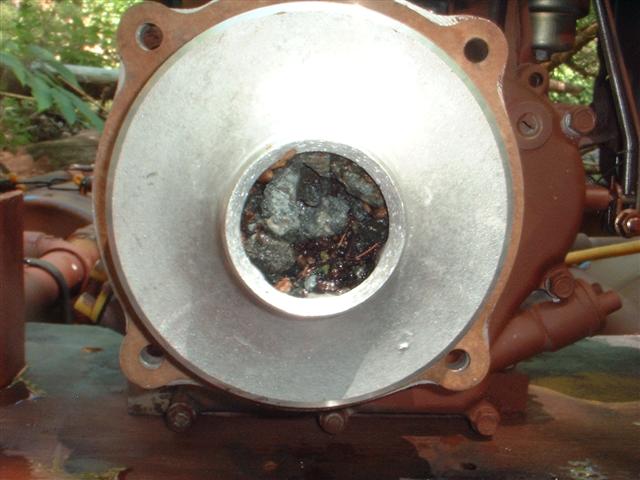

I have no idea how to fix such a amateur mistake :oops:
But if I had to guess I would suggest just taking off the volute if the back flush doesn't work, only 4 bolts...10 minutes tops
DSCF0006 (Small).JPG (53.2 KiB) Viewed 4688 times

Postby golden optimist » Tue Jun 21, 2011 7:23 am
Dan:
Thats a picture of someone elses dredge pump, right?
Re: P90 Pump Clog Question
Postby russau » Tue Jun 21, 2011 1:34 pm
Leonard, thats your pump that Corky borrowed last week and forgot to tell you about it!
Postby Bonaro » Tue Jun 21, 2011 1:41 pm
Um...kinda.
The pump belongs to my buddy but I am the one who clogged it. :?
