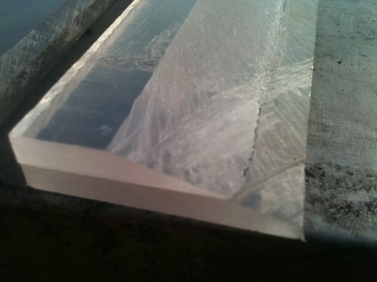

I started with 1/4" polycarbonate. Cut to 6" width. Then glued 2 of them together to get the 1/2" lamination. You can then use a GOOD table saw to rip the 15 degree taper on each edge. Then cut to width. (I cut mine 2" wide). See 1st pic

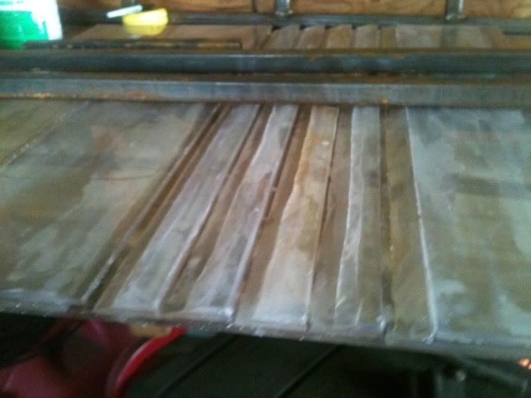

When ya get a supply of tapered stock, then you can start to glue it down to a smooth sheet of polycarbonate using standard PVC heavy duty cement. Start with about 12" of slick zone prior to riffles. I alternate slick settling area with riffles. See pic 2.
Looks rough til you block sand the tapers. Or size it to your sluice and let the gravel do it for ya.
