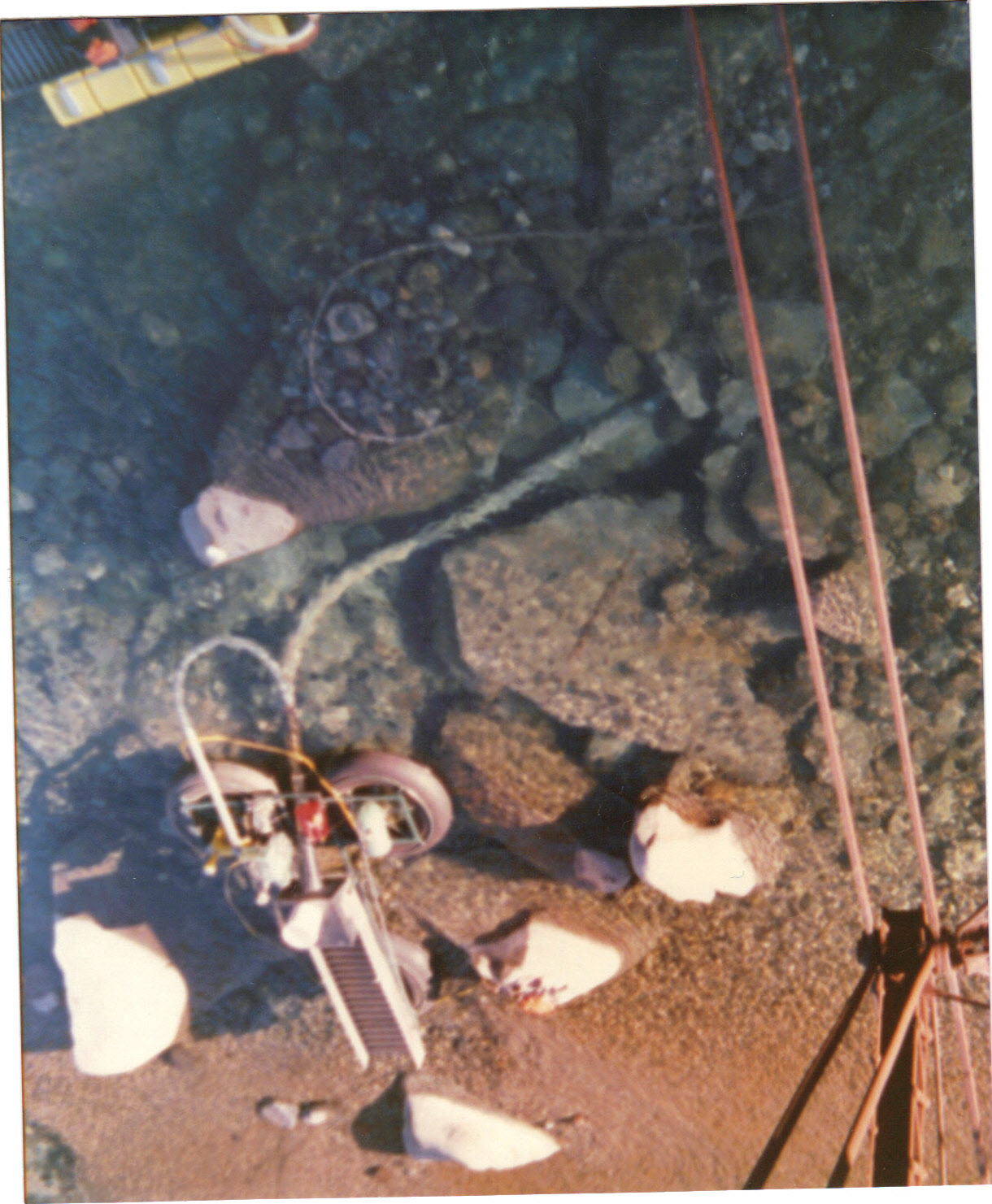

Your idea will definately help as you've retained the bottom lip to help seal and your riffles are then like a modified hungarian utilized in dredging with the ol'school hungarian lip on the bottom somewhat like a backwards L. Seen before and works just fine in both dredges and sluices. I always get a chuckle when I see ol' PESCO,Gold King and Promac pieces out in the field as not in biz for many many years but equipment still lives on. My great Bud Bob still has a 4" Spartan style dredge by Karl Von Mueller from the 70s. OOPS forgot Fieldler-Felder dredges too. John ..Leonard just upped the pic size allowed and I'm horrible at reduction but just go to bottom of post,left click attachment,left click on your computer file in brouse mode,find your pic,left click on it to pick it and left click on download till the file name appears. When writing a story stop typing and add the pic when writing and use inline,then type more and/or add more or just hit save to put at the end.
Felder at Purdone SF Yuba,6"
03-25-2011 01;08;27PM.JPG (365.39 KiB) Viewed 6594 times
