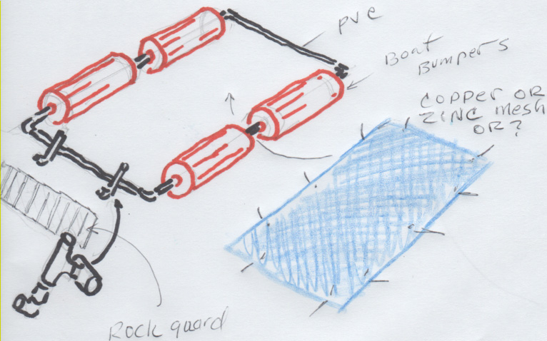

Postby poprivit2 » Sun Jan 06, 2013 5:42 pm
If I was to make one, I would use some 3/4 '' PVC making a 2' x 3' assembled frame with 2, or more depending how long it was made, hole thru middle boat fenders for flotation. The PVC would pass thru the hole in the fender, then some of that copper mesh tied together to make a nice thick mat. That could be tie wraped to the frame. Tow the frame down stream about 6'' away from the sluice end. the outflow should keep the "filter' off by the flow.
This would also slow the discharge slightly and might reduce the turbity.
A piece of expanded? in front like a little plow dould divert the more energetic rocks from making it into the filter.
If it even worked a little it would be cash in the pocket, And a lot of thumbs up too.
I'll try to draw one up and post. along with bumper sizes etc.
POP

Postby Bonaro » Sun Jan 06, 2013 10:55 pm
Zink wool will work better at attracting HG and is about 1/3 the cost of copper

Postby poprivit2 » Mon Jan 07, 2013 9:39 am
Hope this is not to small to see.
POP

Re: Mercury capture
Postby poprivit2 » Mon Jan 07, 2013 9:29 pm
Russ<<<
YOU CAN CLICK TO THAT POST SPOT THEN KEYBOARD CTRL + to magnify the page and immage
but maybe this will be better
POP!
ps looked like it worked !!YEA!!
pps by the way it is like the rolling dredge and can be rolled up the bank to camp or ?? due to the hole in the middle floats.
with spacers between the bumpers to keep from rubbing, like 2-3 x pvc size pvc.
