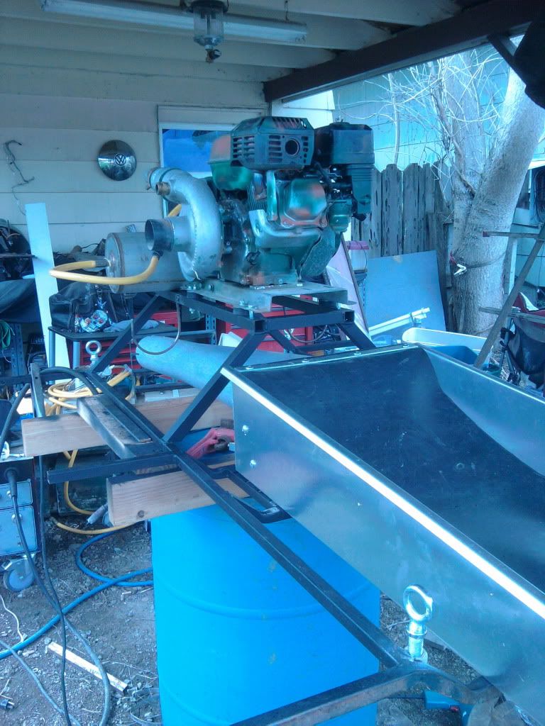

well this year I took the frame bought some alum, a flair, some steel bits and put together a 4" as we got REALLY bored with the three after plugups and the fact that the neighbor went away for a week and wanted us to "babysit" his 4 for him and told us he wanted fresh gas in it when he got back!!! what a difference. (hopefully next winter I will build a 6. I will keep going untill the gubmit and enviros say no more and I may just keep going after that :roll: ... super quiet, incog operation should get her done!!!here is a picture of the project so far, I did all the frame mods to get the motor up over the flair bent the sluice on the brake. It is a two stage sluice O/U with expanded metal over miners moss over carpet on the bottom and a clone of keene riffle pack on the top section. here is a pic of the progress so far!!

:D and the lust continues as definately a terminal disease....and thats not all bad-great pix/story-John :lol:

Another camo dredge! Yeehaw! :D :lol: :D :lol:

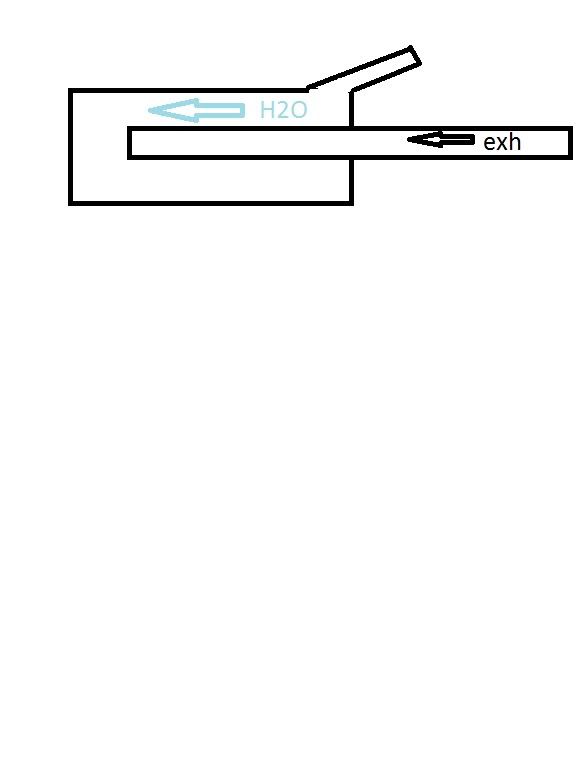

I thought about the extended muffler into the water trick and thought about the backpressure it would create and thus burning up valves. My thought is to run a pipe down and alongside the float and at the end have an outer sleave and inject water with the flow of exhaust. kind of like they do on the inboard outboard boats? was going to give it a shot and see whats up... Something like this:
