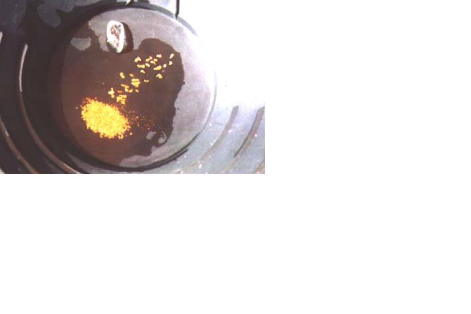

So in short Miller table for cleanup of +100 mesh cons out of primary sluice only in order to obtain clean saleable gold which I am fortunate enough to have running at 960 fine on these placers. The nuggets will be kept back and only the smaller non jewelry gold will be sold. I will post a pic of the gold from my claims . Sorry but its not the best pic.
This is the gold from one 6 cubic yard test pit.

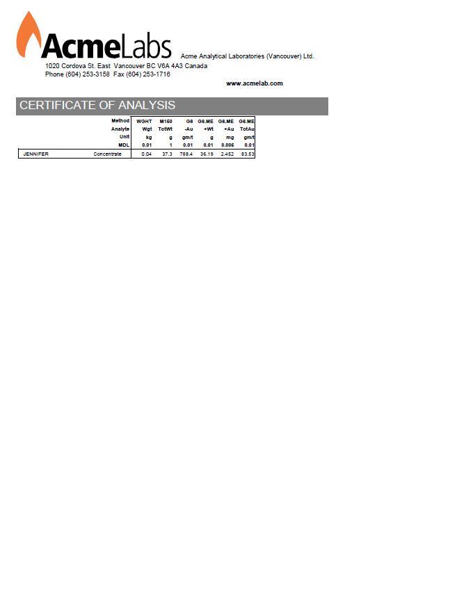

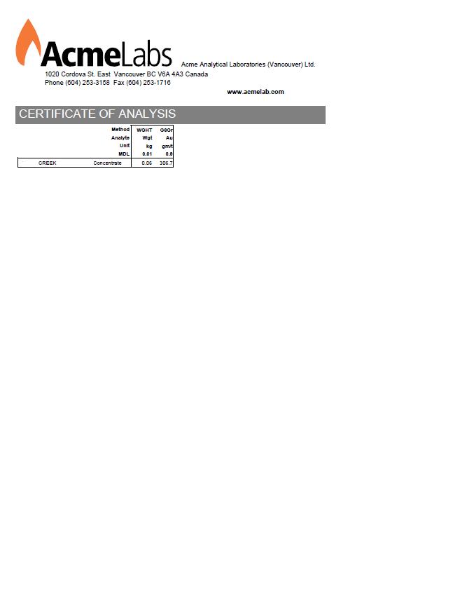

Yes I did the assays just in the past couple months. The gold is free gold it is just real fine micron gold in the -150 mesh size for the most part. In the assay below you will see that there was 788 grams per ton AU in the -150 screen portion of the assay and only 2.45 grams per ton of AU in the +150 mesh screen portion.
So that tells me that the gold wheel did a descent job of the over 150 mesh gold but fell far short of catching -150 mesh gold. I know -150 mesh is puny little powder gold basically but at 788 grams per ton I gotta at least put in an effort to catch it . If the miller table wont do it the I will have to spend the big money and get me one of them fancy extruder shaker tables. I probably will buy one anyway after I get mining for a month or so but I will need the cash flow before I can justify a 25K purchase for a shaker.

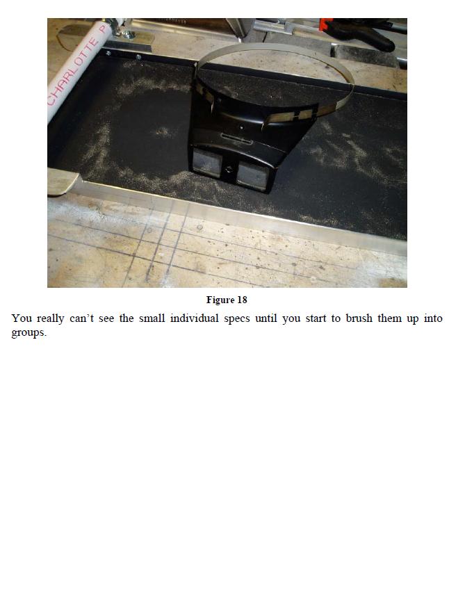

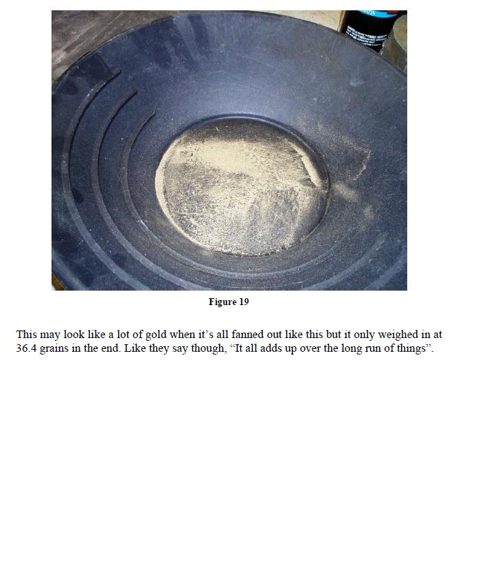

I think the miller table will work as well.These pics showing the fine gold that can be caught with a Miller table sold me on the idea originally. I am about 75% done my miller table build and I hope to run a test with it next weekend.

looks lik you got it nailed! but, with the water supply up high to your sluice, how do you keep the rippels down in the water? i have mine going into the back of my Miller table sluice and a sponge in front of that to keep it all even,like a peice of glass so i wont disturb anything.and i also get small fines like you have there. i guess a person cant argue when you have success as you do! it looks good in any event! i used 3/8 inch slate material(old chalkboard) on mine,it appears that you used the blackboard spray paint??? i used that originally but it needed maintainance occasionally (repainting) and i got the slate for free and tried it and i like it better!

i have a autofeeder to run my cons.it works great on the bigger small stuff(+20). but when you do the _20 on down you really need to set your feeder as close to the sluices surface as you can and slow the feed rate down even slower.i ran mine last week getting gold dust and if the feeder is to high,itll cause ripples in the water and (worse yet) bubbles when the water/material hits your SMOOTH stream of water,and this will cause the really small stuff to move around on the table and possibly over the end.ive also seen that nomatter waht you do to the end of the slates tailings edge(round it over or squared edge) the cons will build up right at the edge. i was told that rounding it over would eliminate this problem. but as it turns out,i dont mind a small amount stopping there so i can eyeball it to see if i missed any of the micro fine gold. the +20 gold stays towards the top of the sluice bed and dont move. but you need to keep a eye on the really small stuff and use a few small drops jet dry(depending on your tank size)and some clay-gone wont hurt anything either!i have my bilge pumps on my battery charger and set the charger for 6 vdc to slow them down. i have 2 750 GPH pumps but you dont need near the GPH. 500 or lower would do just fine.i have valves on these pumps to furter tune my system and the suto feeder has 2 adjustments aswell. up/down/tilt. the smaller the gold, the slower you need to go to capture it. HEY! a guy has to have some fun during this nasty weather! im still looking for my bucket of cons from dredgeing the Arkanas River with Leonard.ill mark my buckets next time!!!
