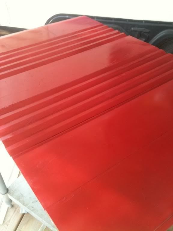

Like you, Russ, I have a full sized machine shop at my disposal. But I was looking for a way that a regular Joe could build 'em cheap & easy. This works well although kinda heavy. Vary your riffle spacing and depth to suit your needs. Don't be afraid to experiment and throw something different in there. Zooka always argued with me to use avariety of recovery methods. Why build a box with all one kind/size riffle throughout? If it don't catch in the first few feet, what makes ya think 8 feet of the same thing is gonna work better!
(if the pics are too large, size 'em down for me, Russ. Hard to fix on a phone)

Russ, I have built these drop riffles in aluminum, vacuum-formed ABS, fiberglass, and finally polycarbonate. This last is a way that all can do it with minimal building skills. For those that want to give this a try, don't get discouraged if your first attempt does not work as expected. Mine didn't work right either. Ya got to balance the drop distance with the riffle spacing.
By the way, this one is set up for tiny gold in Alaska, mostly 30 mesh. And it is operating under 1/8 inch punchplate. Bigger gold might need more aggressive riffles and a wider spacing. And just in case something screws up, there is still Nomad under expanded, and some Hungarians farther down the sluice.

Postby micropedes1 » Thu Jun 09, 2011 3:33 pm
Oh, and here is a pic of a finished panel. As to recovery....lets just say that I have faith in them. Recovery pics later.

Sierra, you are using a different kind of beast entirely. Raised riffles operate best when you have sufficient velocity to create a vortex behind each riffle. This has the effect of sorting heavies farther and back under the riffle. But it also throws your very fine gold back up into the moving water stream, sometimes to be swept away. Drop riffle allow heavies to hug the bottom in a more laminar flow. Lower velocity. Better fine gold retention.
I do not use a shovel. These riffles are going in a 10" dredge.
