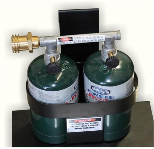

The weight of a 25 pound propane tank would be the same as fitting your dredge with a 5 gallon fuel tank....too big
My idea was to make a manifold that I could screw about 3 of those camp bottles into, that should be about a days fuel needs
The bottles could be changed on the fly
Propane-Containers-copy-996x996 (Large) (Small).jpg (26.67 KiB) Viewed 6325 times
