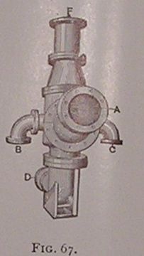

Postby Plumas » Sat Jan 01, 2011 7:55 pm
CAlGoldDredger
That image seems to be a variation of the Ludum type design.
Attached is a small image of the business end of an Evans' showing the auxiliary intakes. A is the main material intake. B and C are the auxiliary intakes. D is where the water enters the device and F is obviously connected to the elevators lift pipe.
All of the connections had swivel type connectors allowing things to move while it was in operation. Suction hoses could be attached to auxiliary intakes to drain unwanted water or to to clean off bedrock just as we do with our dredges today. Those old timers were pretty smart people.
