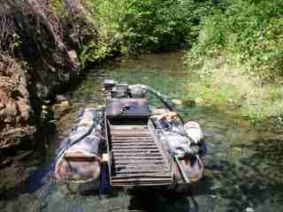

Postby Hoser John » Fri Oct 07, 2016 6:11 am
:( if only instead of being flushed out into the gulf...John PS... hear no evil(low tone mufflers) see no evil(see pic) and speak no evil (I don' need no stinkn' permits)
what dredge hahaha.jpg (16.05 KiB) Viewed 14936 times

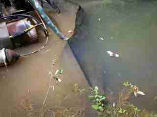

Postby Hoser John » Fri Oct 07, 2016 6:46 am
kali dry but strong minds do prevail
100_2231recirc camo.jpg (11.39 KiB) Viewed 14936 times
